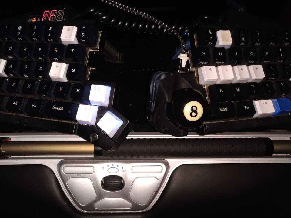

Usecase: Thumb Trackball
Summary
This is my main mousing setup. The main idea is that base layer 7890 keys are bound to mouse buttons, so the trackball module + 7890 keys act as a full-value thumb trackball.
features:
button action bound action
7 tap / hold left button
8 tap middle button tap
  hold + 7 rocking gesture: switches browser tab to left
  hold + mousing scrolling
  hold + 9 rocking gesture: switches browser tab to right
  hold + 0 close tab
  ploopy (external qmk-powered trackball) interoperability via numLock.
9 tap / hold right button
0 tap new tab
7+9, 9+7 actual middle button hold
Details of the setup:

Ploopy / NumLock
My Ploopy trackball is programmed so that if num lock is on, it scrolls, otherwise it moves cursor. Furthermore, the middle button macro taps numLock on press and then again on release, so both UHK and the Ploopy trackball scroll when 8 is held, and control cursor otherwise.
