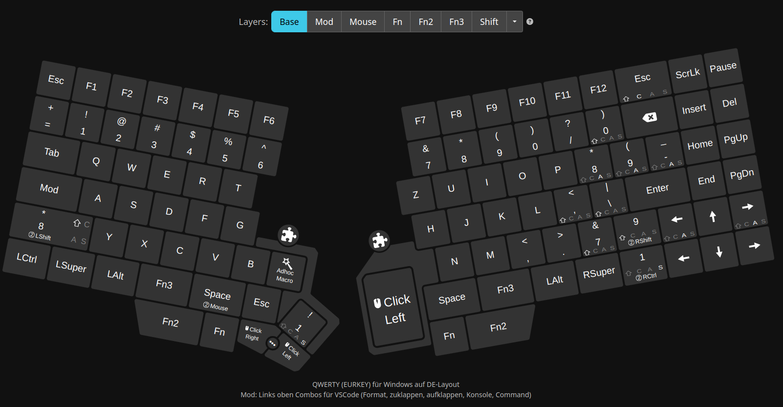

my company uses german standard layout on all machines, but I’ve changed to Eurkey some time ago. Because it was driving me crazy to change the layout on every machine I log into, I made a layout that let’s me type in Eurkey by translating the layouts.
I’m not yet done with the complete layout, but the base and shift layers are done and i have implemented the parts of Eurkey, that I need to type with german special characters.
As a bonus i have integrated space cadet on the shift keys.
Keymap json:
If you want to try it, just paste the json into your own config.

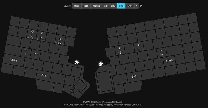

The keymap translates the German system layout to us international/eurkey. So the os is German, but the Keys are moved to other positions in the keymap.
The Umlaute are reachable via fn3+aou and s for ß.
