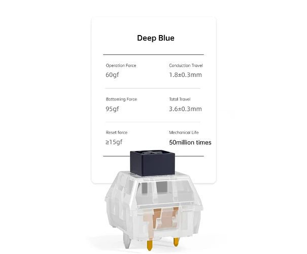

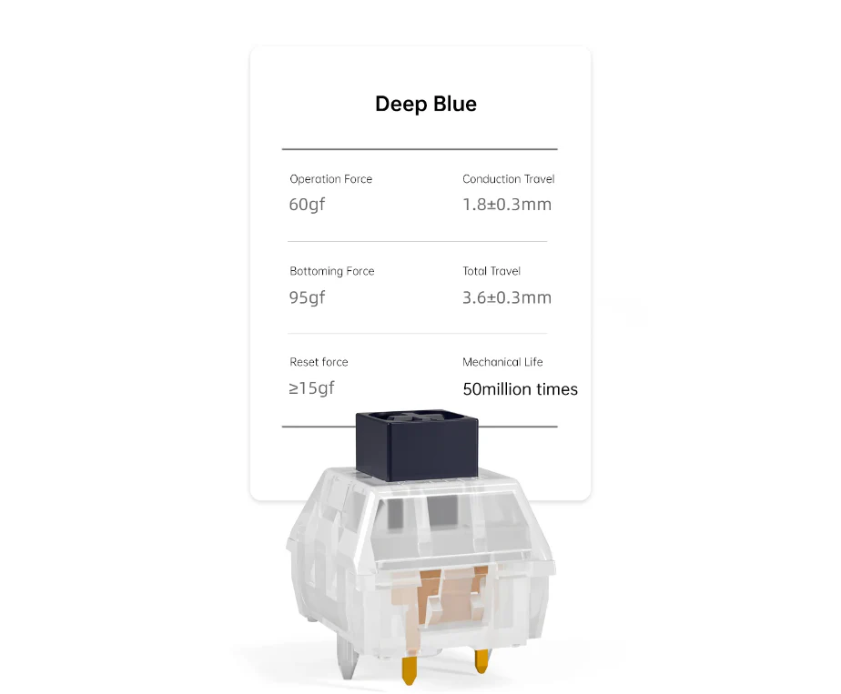

I have Box Whites in my UHK60v2, and I agree they’re a very well-rounded clicky option for most people. However, If you like em heavy like the Model M, I recommend the Kailh Box Crystal Navy switches. I have those in my UHK80, and I absolutely love em. The most tactile & LOUD MX-style switches I’ve found so far. Look how heavy the bottom-out force is on these suckers…

Wow, that’s heavy!

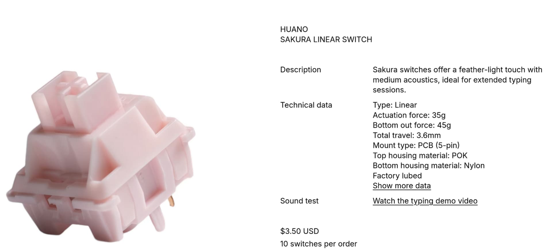

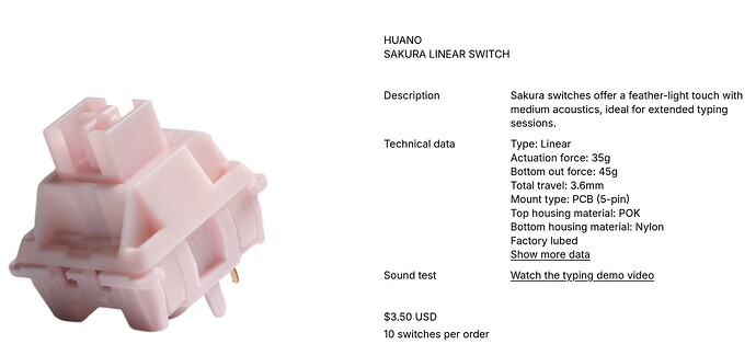

I recently got my UHK80, I’ve been really liking Huano Sakura linear switches for it. Not too loud, not too heavy, just right linears in my humble opinion.

Yeah, they’ll wear you out pretty quick. I just need the extra tactile feedback because I have nerve damage in my hands. Numbness & tingling in my fingers makes it hard to feel any switch under 60-80gf.
