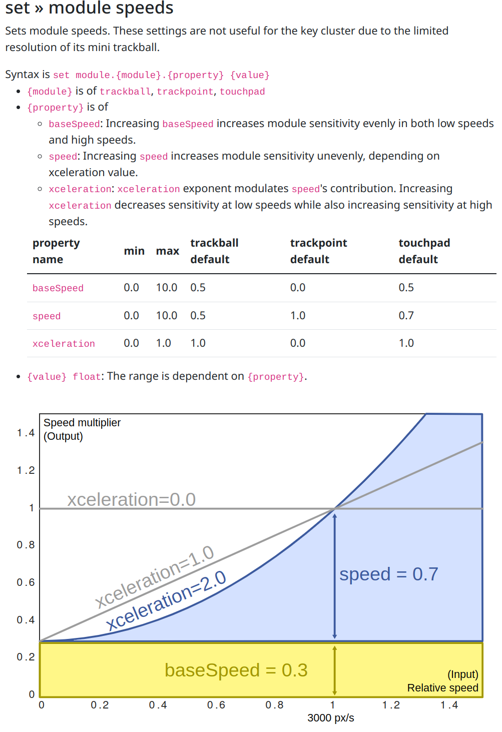

I meant macro configuration of module sensitivity. It allows increasing sensitivity in high speeds independently of low speeds (informally called acceleration), which means that I can easily do sensitive operations at low speeds, but then cover full width of 4k monitor with a single swipe.
See following section in the Agent’s smart macro side pane documentation, or Configuration section of https://github.com/UltimateHackingKeyboard/firmware/blob/master/doc-dev/user-guide.md .

xceleration of 3 doesnt make sense though, if 1.0 is max according to your image…
What exact values do you have?
Those ranges are just recommended for regular usecases. If you know what you are doing, you are welcome to go out of those ranges. Actually, trackpoint is not very suitable for this kind of manipulation, so extreme xceleration value may make sense…
