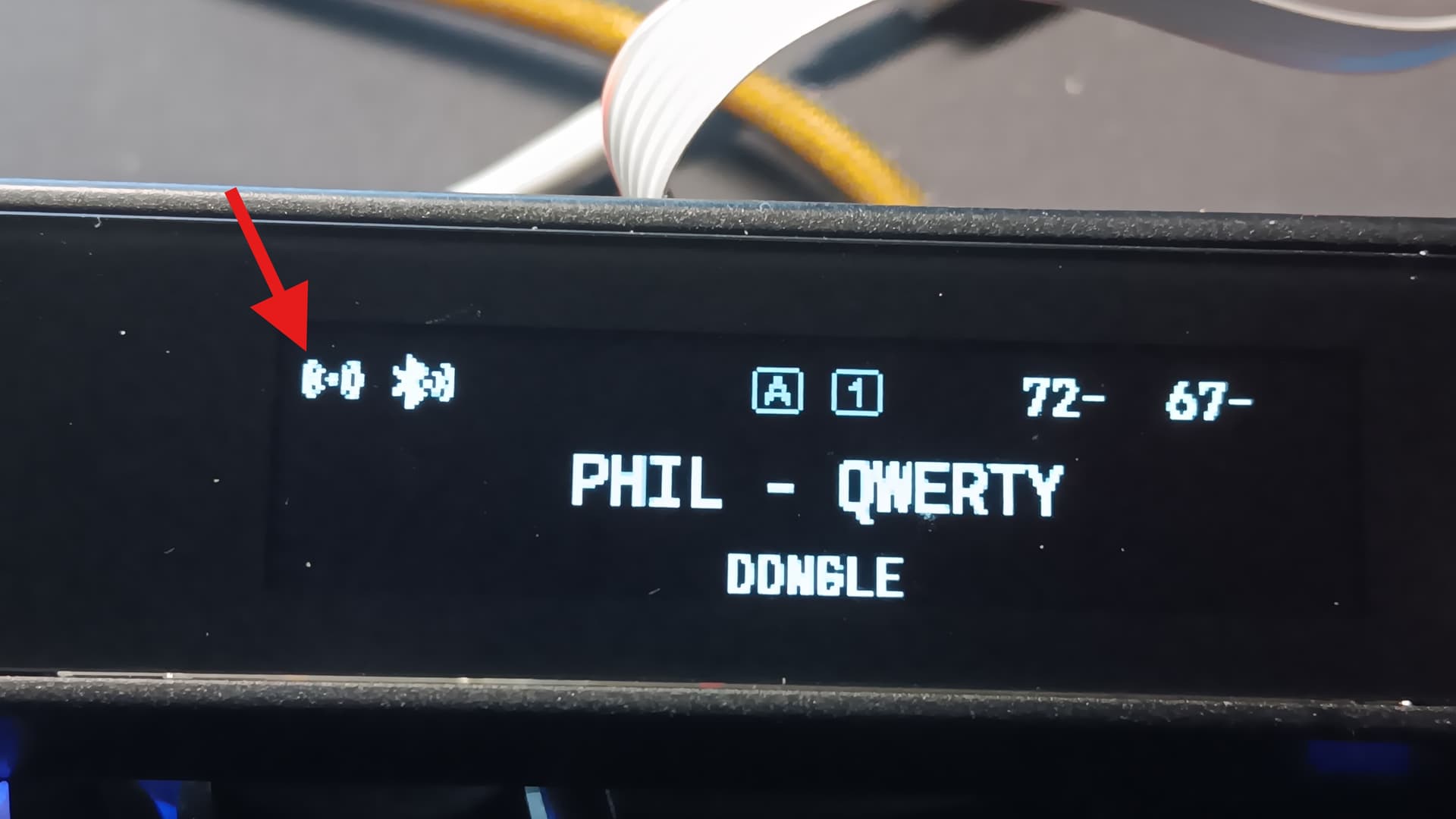

It should auto-switch to wireless mode when disconnecting the bridge cable. Do you see a wireless icon, or a circle with an “X”?:

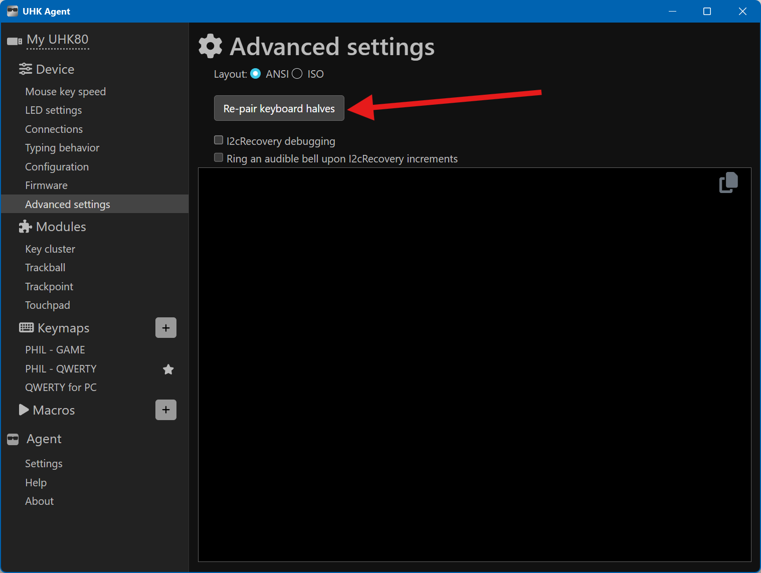

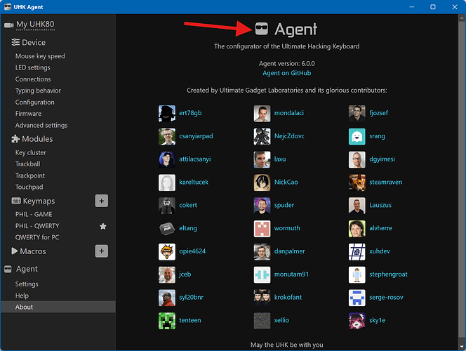

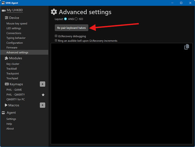

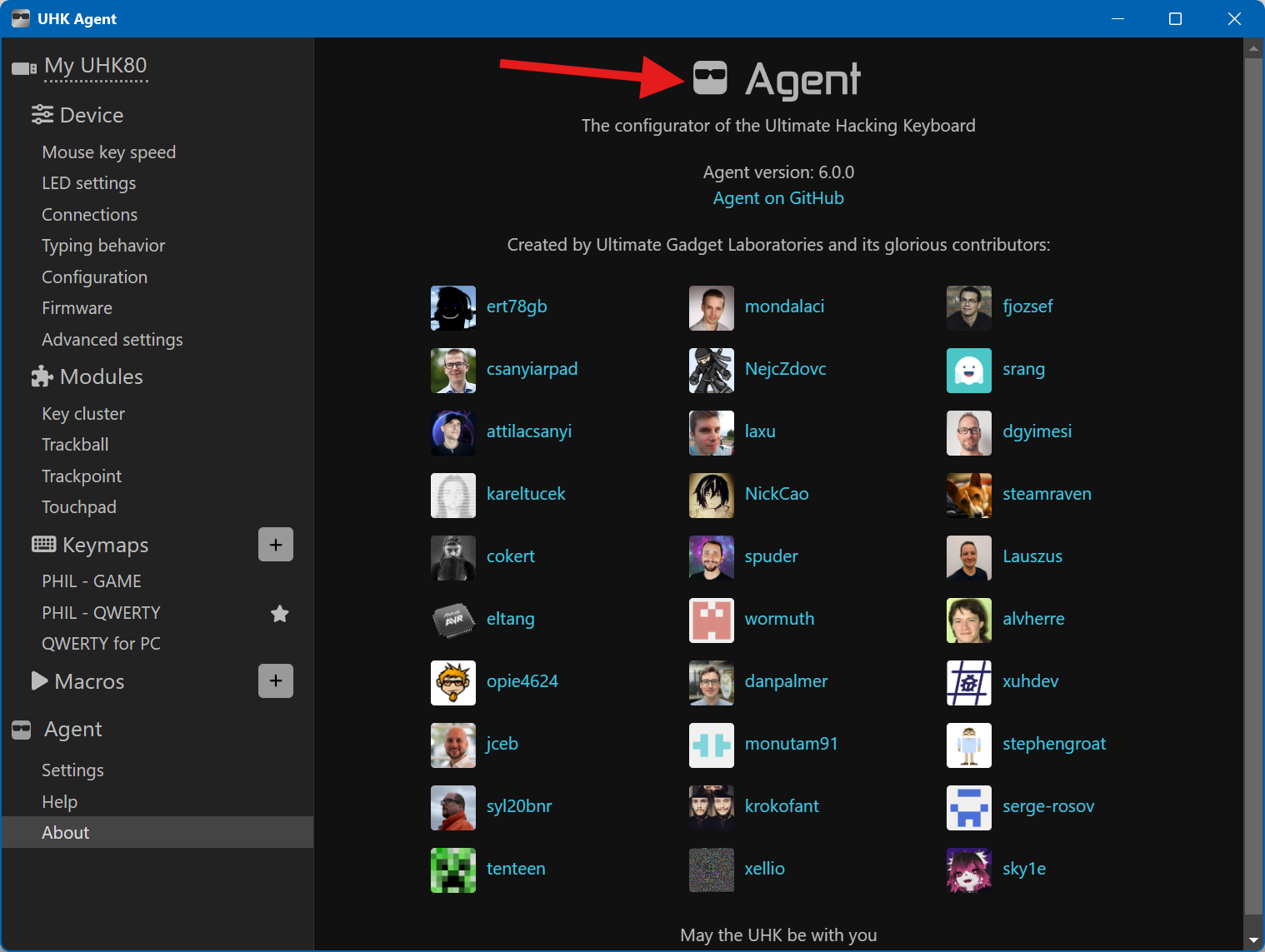

If that doesn’t fix it, then open Agent to the “About” tab at the bottom of the left pane, and click seven times on the Agent icon (grey square with sunglasses in the main window).
Then scroll back up to the “Device” section in the left pane, and look for a new “Advanced settings” tab. Then click the “Re-pair keyboard halves” button in the main window.
