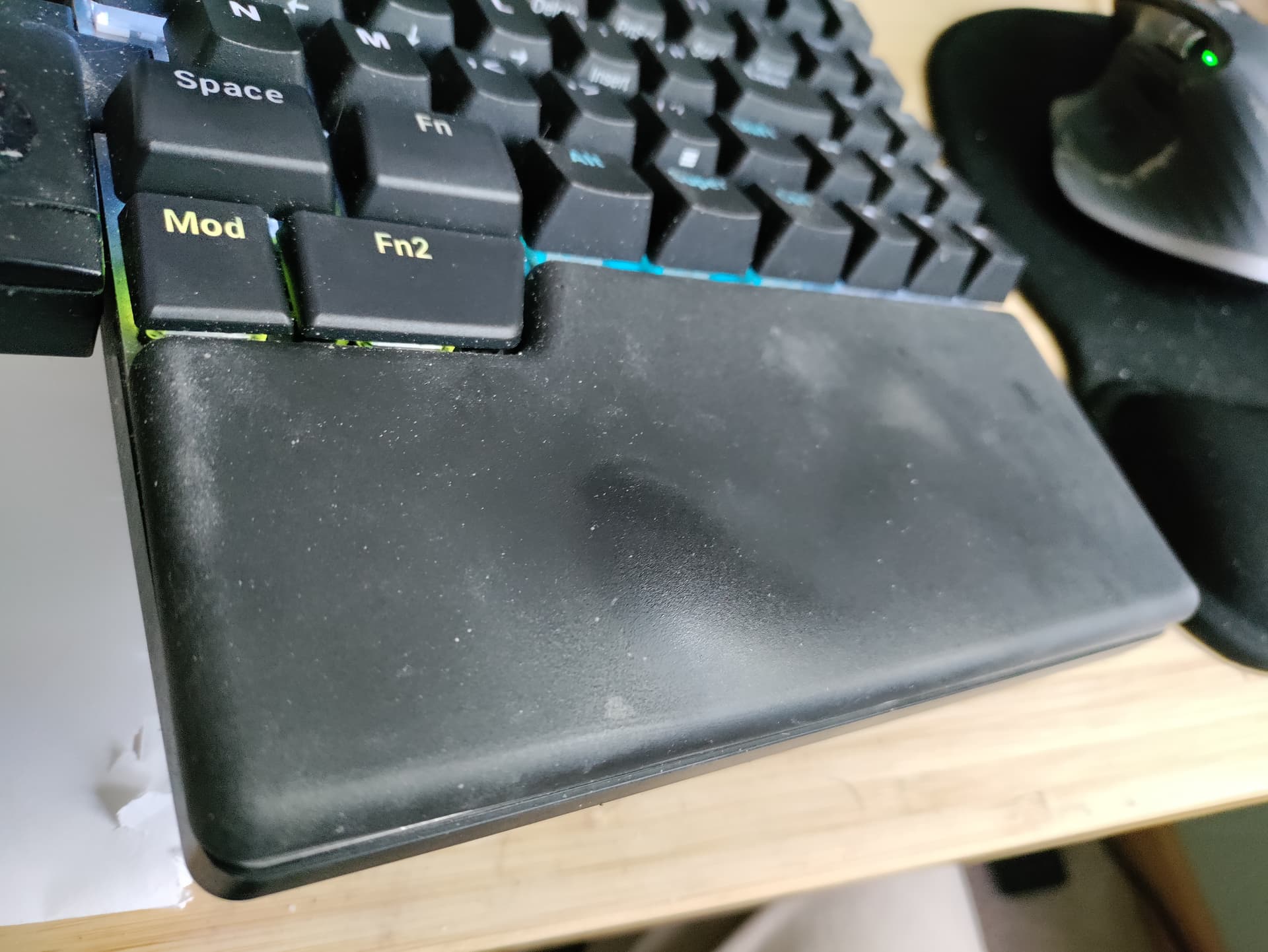

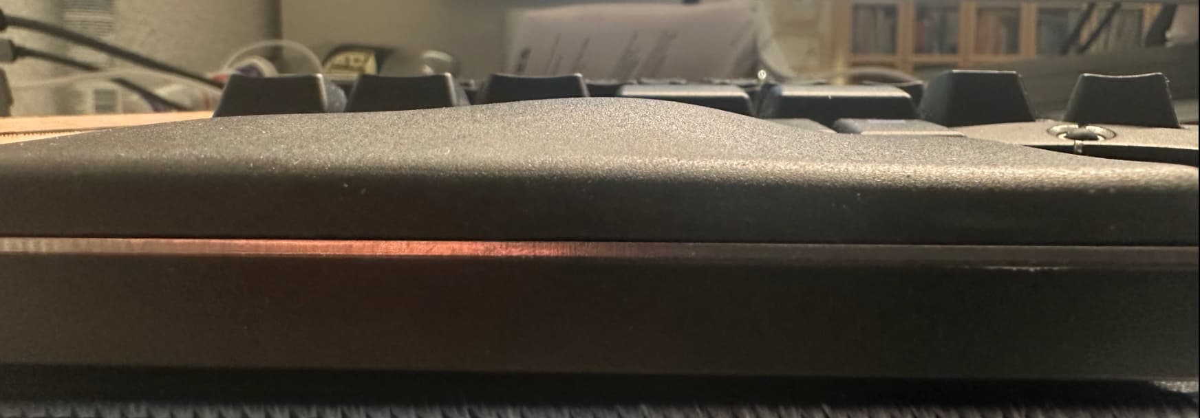

I have this problem as well. Pics:
I received the “your order is ready to ship” email on January 21, 2025.
Unfortunately mine is now reaching the point where it’s starting to become unusable. The bubble is so high that it regularly pushes the top of the pad out which is then getting caught on the bottom row of keys.

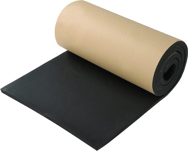

I’m going to look into a DIY solution while we wait for a proper resolution

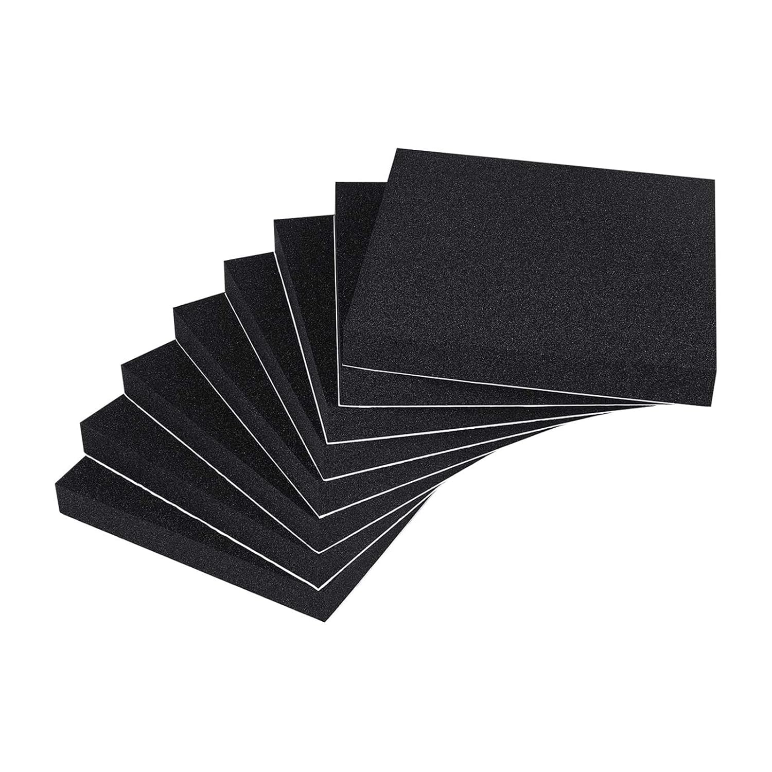

Edit: Going to give this material a shot, note the preview shows the 1/2", but there is a 1/8" option. I measured the current pads thickness as about 1/8" (3.175 mm)
This will be here Friday, I’ll report back once I’ve installed it.

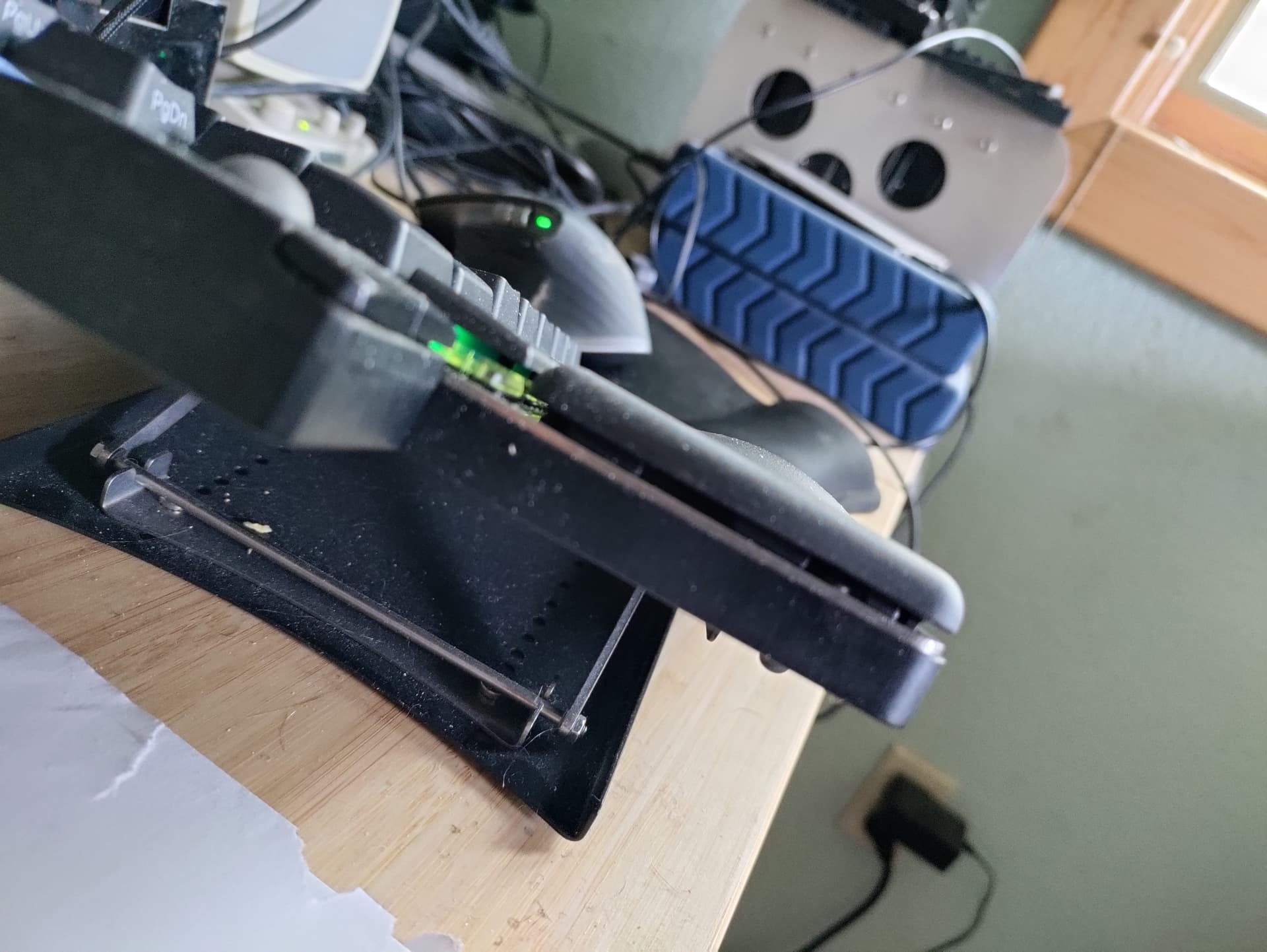

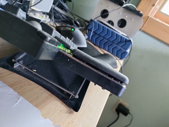

Has this happened to anyone that does NOT have the riser?
shipped 11.03.2025 :frowning:
Used without the riser or anything—just flat on my desk.
Both sides have that problem, but the left side looks much worse.
I just fixed it with double-sided tape, but I’m not sure how long this solution will last.
I used double-sided tape as well, but unfortunately, it only worked for a month or so. My bubble eventually grew beyond the tape’s strength. :face_with_diagonal_mouth:
No battery
No riser
Just regular usage.

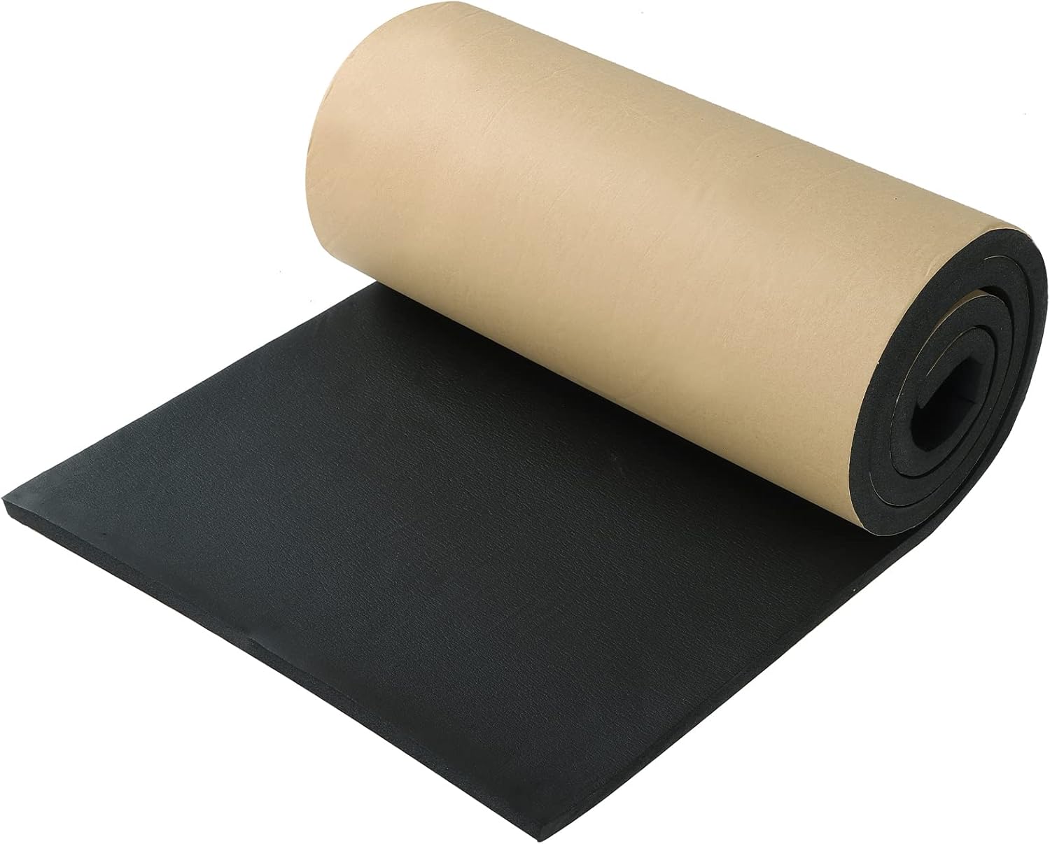

The roll ended up getting lost in shipping so I ordered a different one:

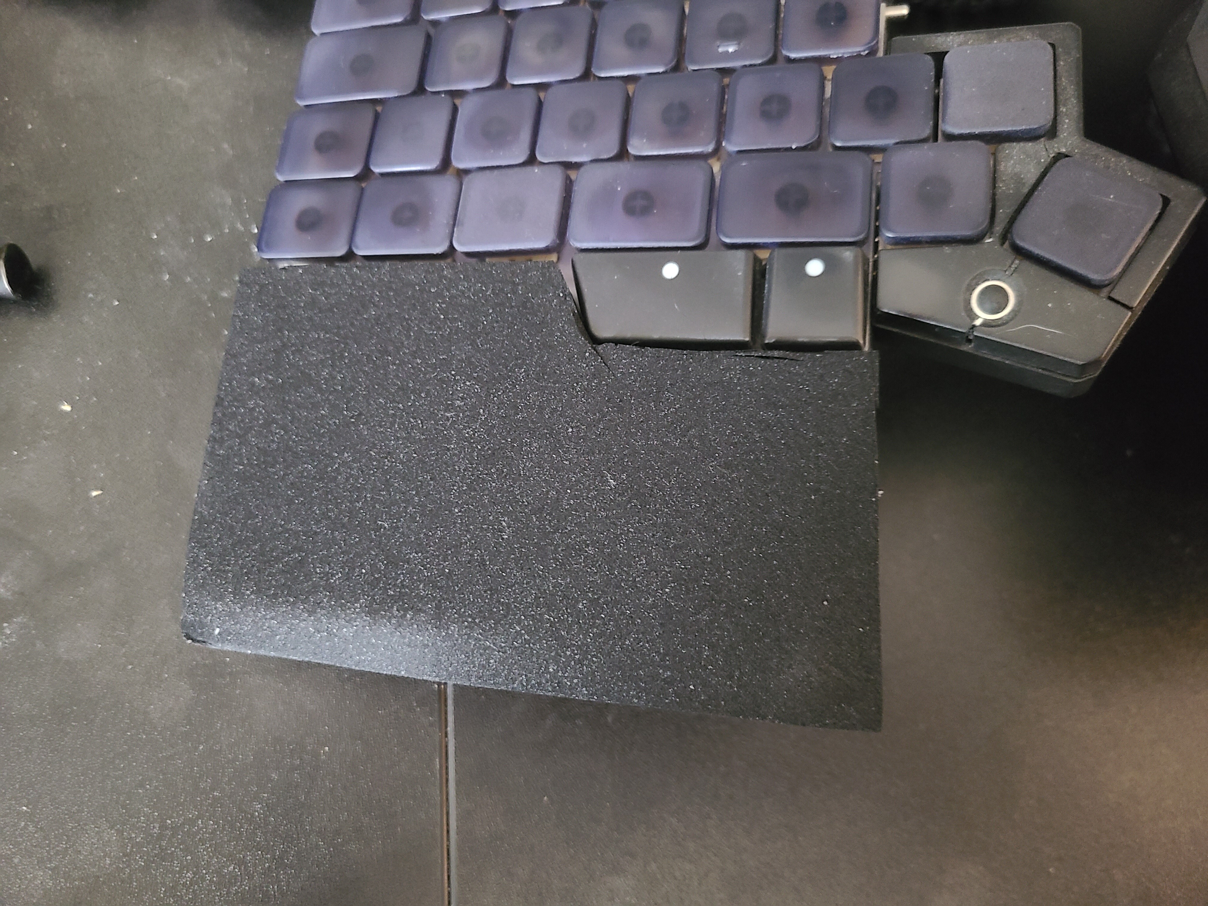

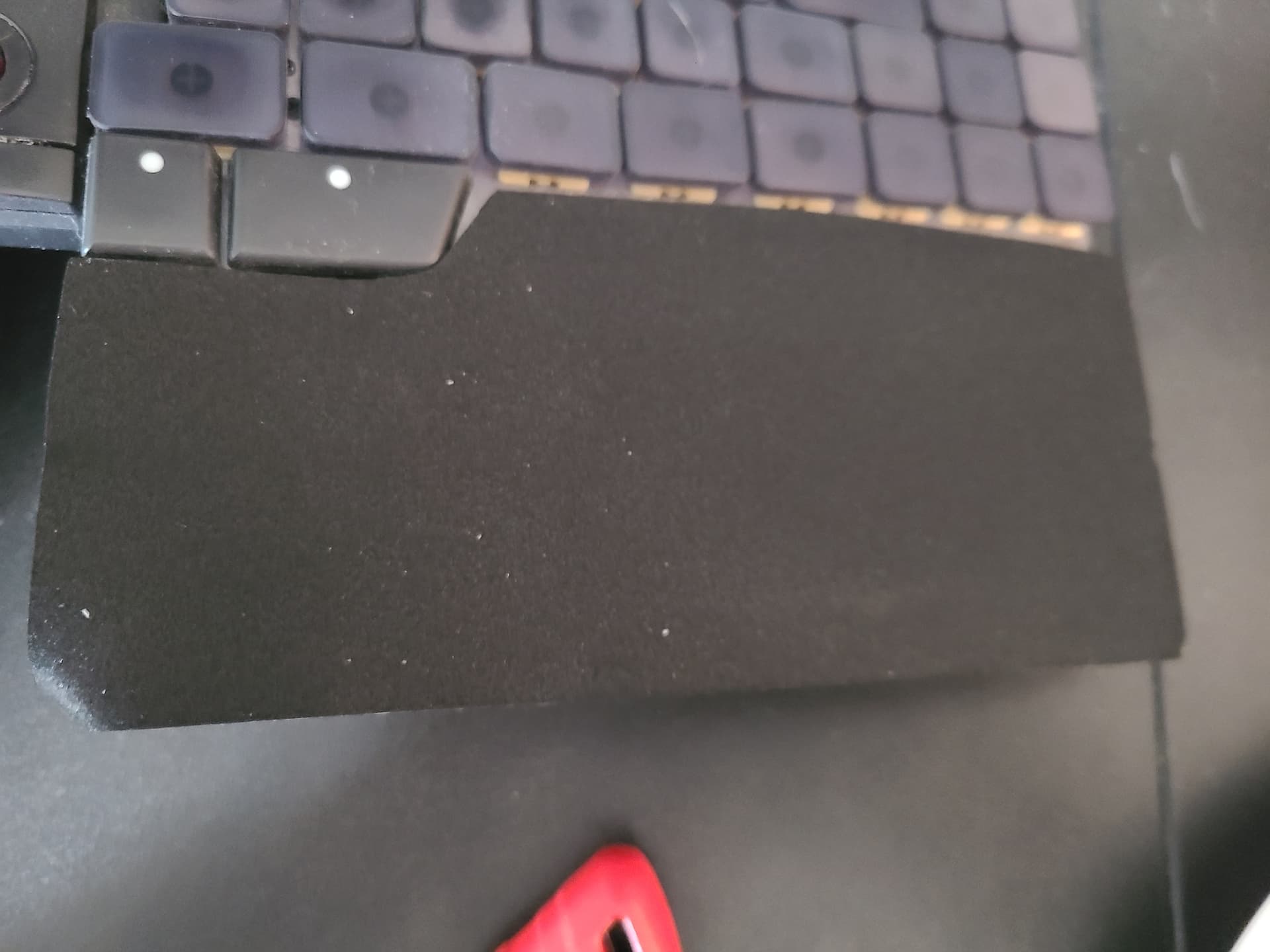

Of the 8 pads this includes I only needed less than half of a single one. It turned out okay, I think I actually would have preferred a 1/16" inch instead of 1/8" now that I’m feeling it. This is still far better than the bubbling rubber which was regularly getting caught under some of my modifier keys, causing them to stick and result in errant keypresses
I just traced the existing pad with a box cutter and used the adhesive backing to apply it to the plastic battery covers. I plan to get replacement rubber once the materials issue is resolved, but this works for now
Just so it’s clear, I’m using low profile switches and low profile keycaps, so my original rubber was also flush with the caps. However the depth I measured of the old rubber (1/8") was accounting for the height of it wrapping around the battery cover, the part on the cover is much thinner, hence me wishing I had purchased thinner foam
