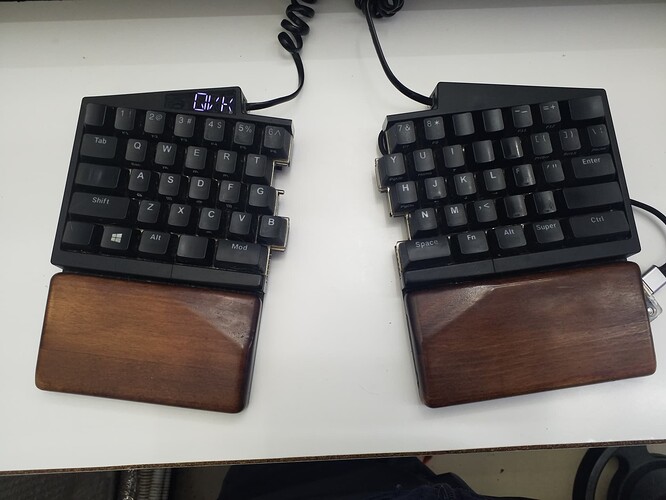

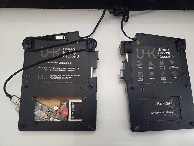

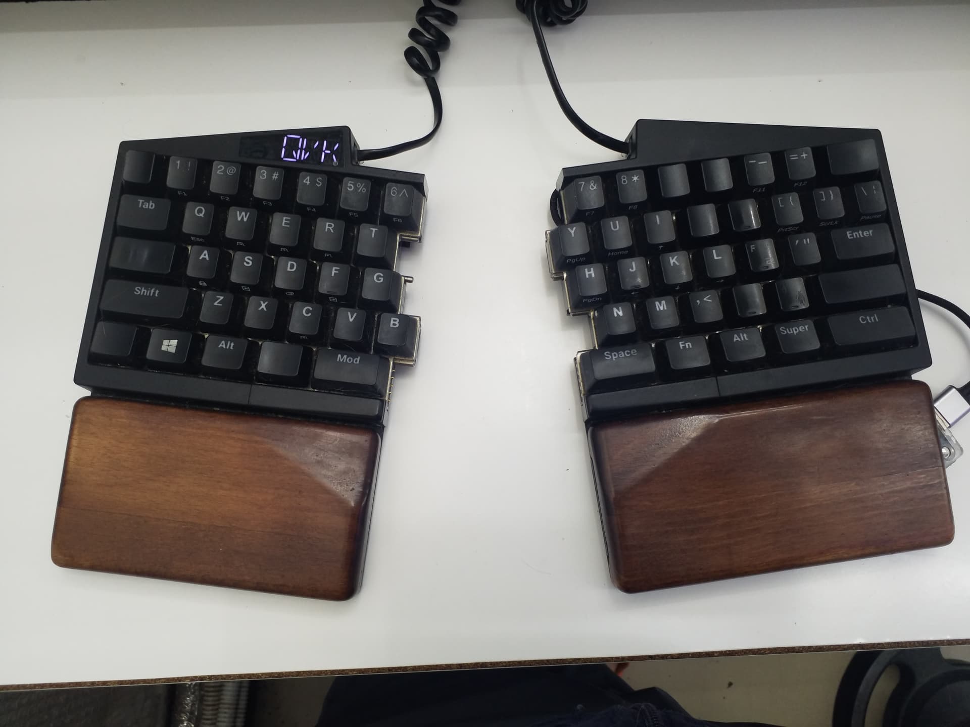

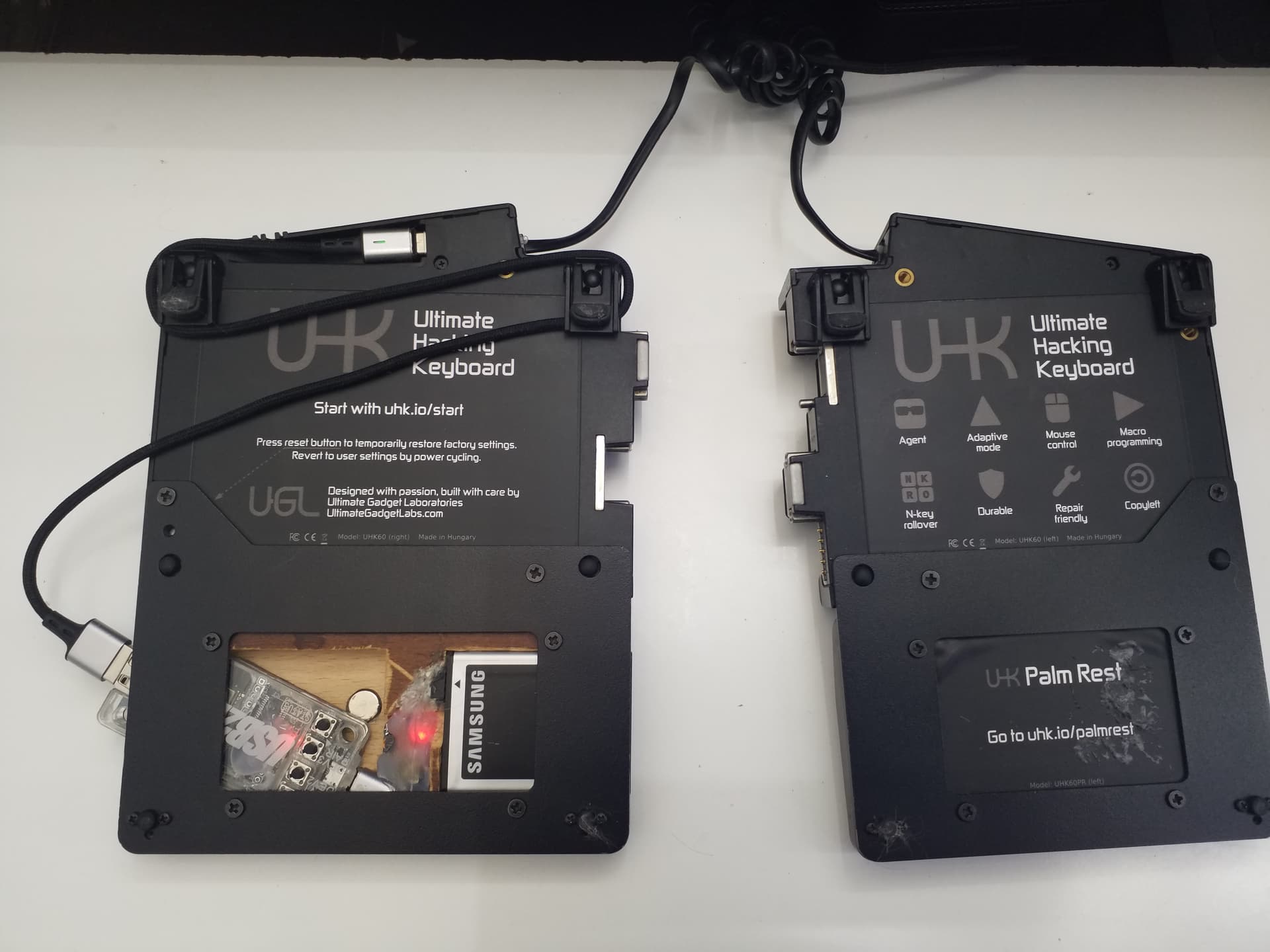

I’ve already converted the UK 60 keyboard into Bluetooth and am using it.
However, the disadvantage is that the line connecting the left and right keyboards in the middle cannot be removed and the short battery life is short.
I lie down and type on my keyboard.
I want to use the disconnected keyboard without the wires I’m connecting to.
