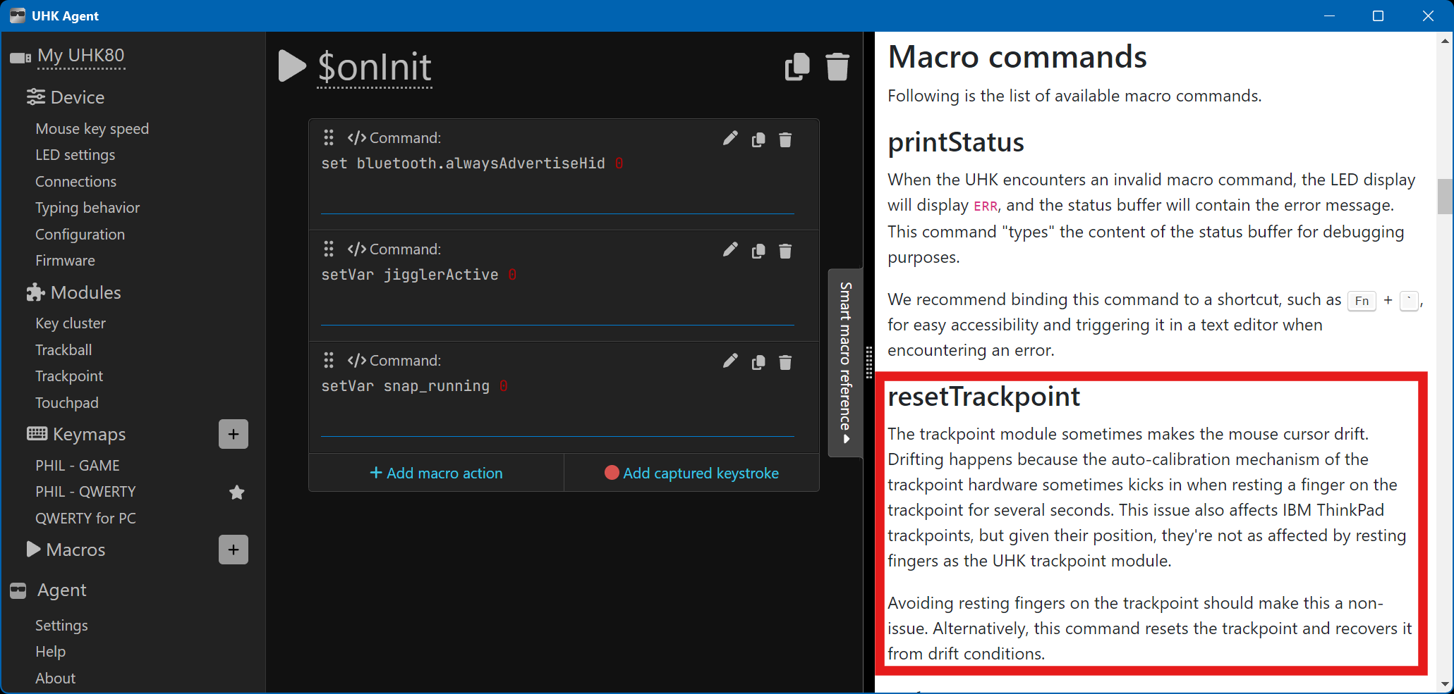

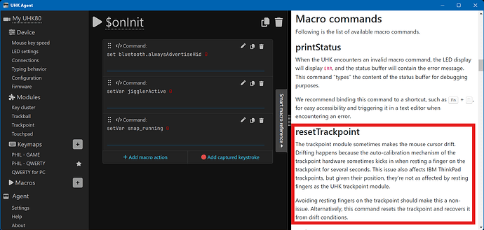

Look for the resetTrackpoint command in the ref manual here:
Uncategorized commands
I also just realized there’s a mention of resetTrackpoint in Agent’s Smart macro reference flyout:
