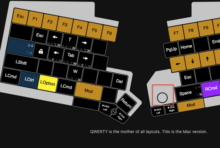

On the trackball, if you use the Mod modifier and move the ball up/down, it scrolls up and down. But it doesn’t always work, and I"m not sure why. As an example, if you open whatsapp on chrome (I’m on a mac), and do it there, it won’t work. Standard mouse scrolling up/down does, just not the trackball. If you thrash it about eventually it does start scrolling though. Just wondered if anyone knew what this might be caused with
