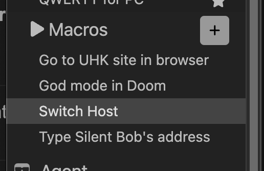

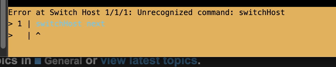

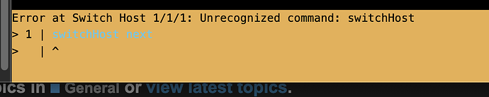

Hi, I just received my UHK 80 and could not figure out how to switch devices.
The UHK 80 website mentions switchHost:
“The switchHost next, switchHost previous, and switchHost last commands switch to the next, previous, and last connection, respectively”
When I try to add this command I get an error:

You need newest firmware from Releases · UltimateHackingKeyboard/firmware · GitHub :wink:
