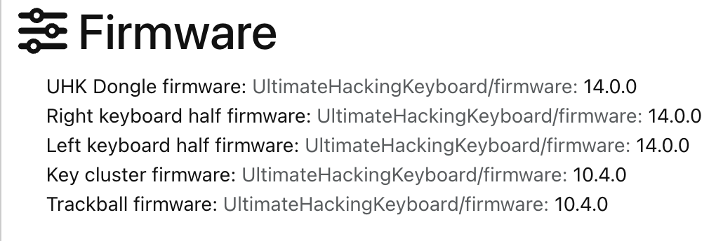

Should I be able to pair with a dongle on f/w 14.0.0?

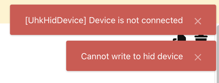

Getting a good bit of errors
Did you update the dongle? i.e. was the Dongle connected to the host when you ran the update through Agent?
Yes, all on the same firmware
get this
and
ASSERTION FAIL @ WEST_TOPDIR/zephyr/subsys/bluetooth/host/hci_core.c:430
os: r0/a1:  0x00000003  r1/a2:  0x00000000  r2/a3:  0x200100d0
os: r3/a4:  0x00000003 r12/ip:  0x2000e660 r14/lr:  0x0003945d
os:  xpsr:  0x01000000
os: r4/v1:  0x200389d4  r5/v2:  0x00000000  r6/v3:  0x0000202d
os: r7/v4:  0x200361c8  r8/v5:  0x200361cc  r9/v6:  0x00000040
os: r10/v7: 0x20011508  r11/v8: 0x00000000    psp:  0x200361a8
os: EXC_RETURN: 0x0
os: Faulting instruction address (r15/pc): 0x0003946c
os: >>> ZEPHYR FATAL ERROR 3: Kernel oops on CPU 0
os: Current thread: 0x200100d0 (c2usb)
fatal_error: Resetting system
