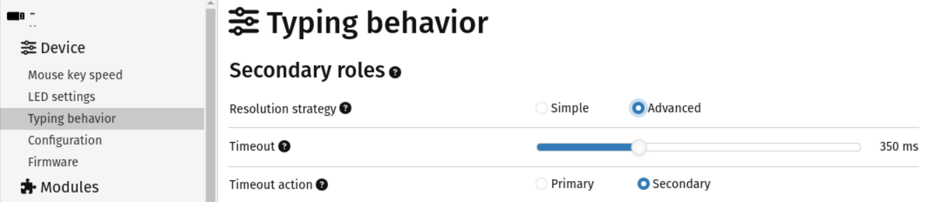

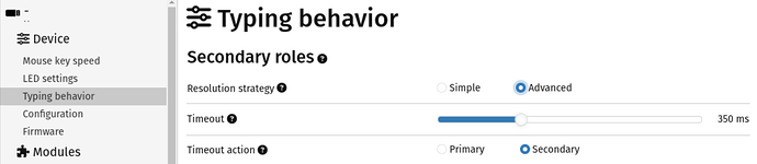

You don’t even need a macro for that.
In Agent, go to the Typing behaviour section, and change the settings for Secondary roles. Set the Resolution strategy to Advanced, the Timeout action to Secondary, and choose your Timeout.
Perfect, thank you, it works nicely now.
