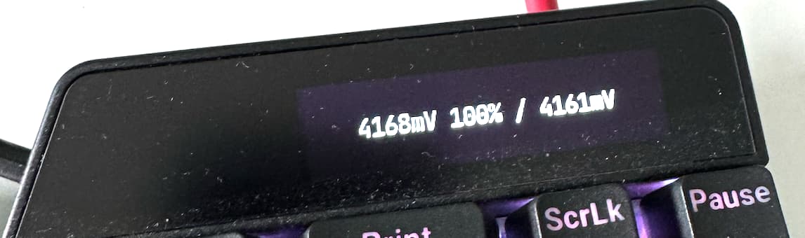

Would you please test the artifact from Max charge behavior · UltimateHackingKeyboard/firmware@37c6065 · GitHub ?
You can also use the statsBattery command, which will show right half’s battery info on the oled display. (It yields slightly different numbers, as they are provided without some of the postprocessing calculations.)
Firmware installed now and will monitor.
Interesting it now says 100% 100% :slight_smile:
