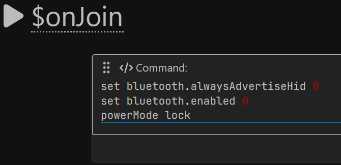

The halves talk to each other, don’t they? So somehow the central (right) half knows when it is joined and when it is split. Agent learns that too via the USB interface, so the right half must know.
This should therefore be possible (useful for people who transport their UHK in joined mode, and use it in split mode):
$onJoin:
powerMode lock
$onSplit:
delayUntil 3000
powerMode wake
Yeah, but not when they are asleep…
powerMode lock is probably fine if you want to transport it between office and home. That will still execute macros, won’t it?
If you go powerMode sleep then yes, you’ll have to juggle the j+l and s+f wake-up shortcuts.
Yes, that one should work.

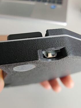

Or include an actual power switch :roll_eyes:.

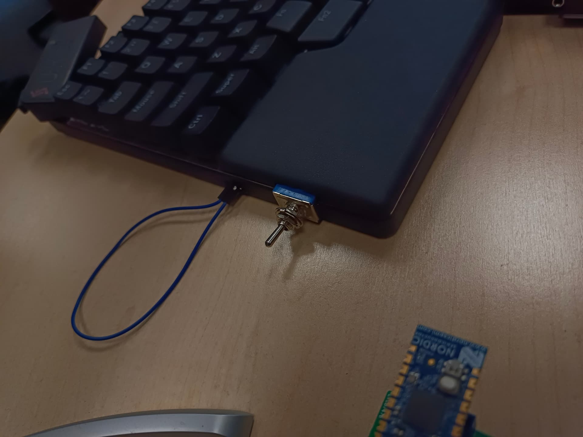

Not a UHK, but something like this would work well:

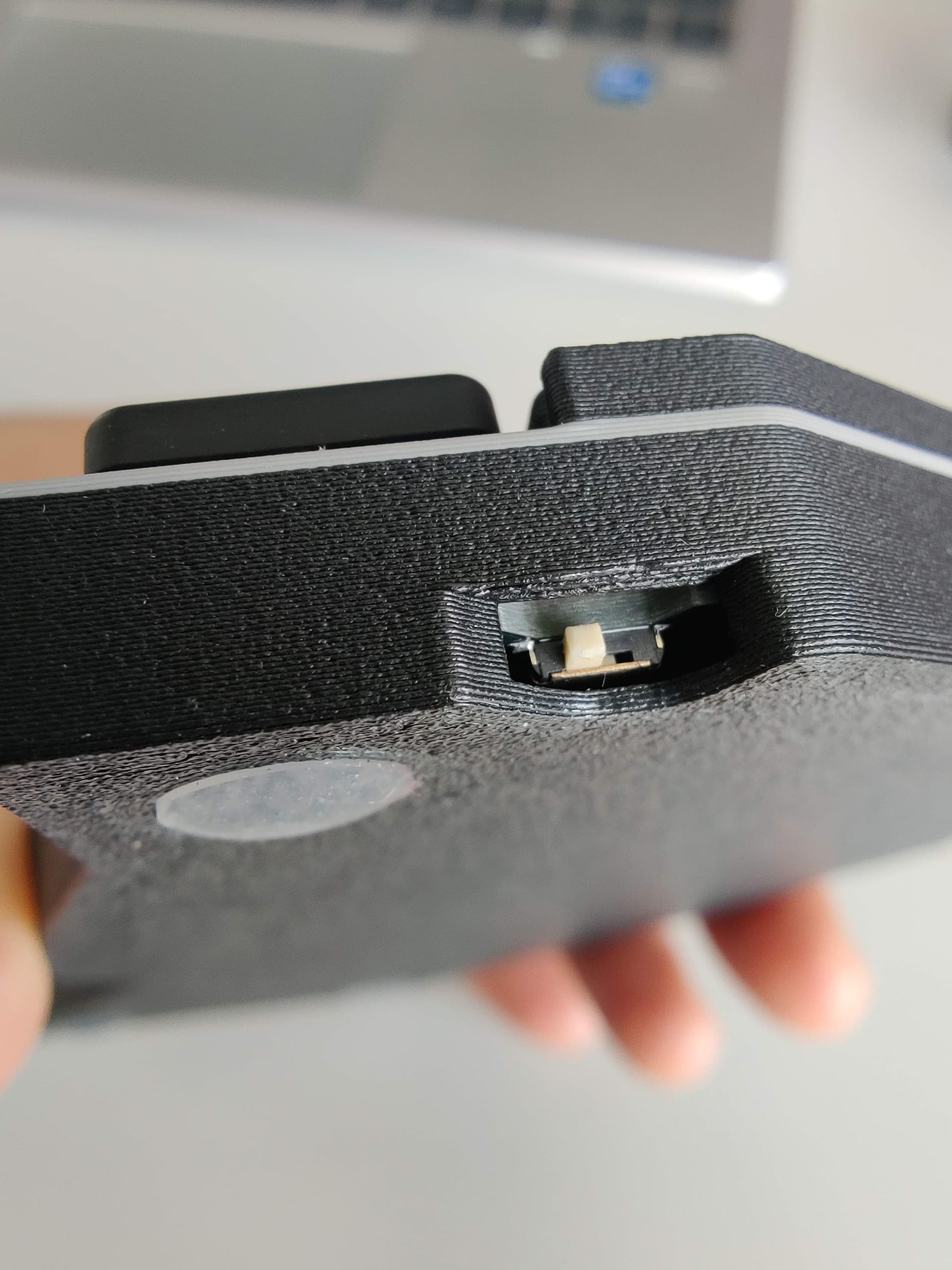

I am using this, and it is super satisfying, although admittedly placing it on the side is inconvenient because of tenting…
Now that’s a BIG switch. Very tactile and clicky. :laughing:
Of course, he went with the blue switches…
Screw it, I’m just gonna go ahead and solder some of those into the sockets on my modifier keys.:laughing:
