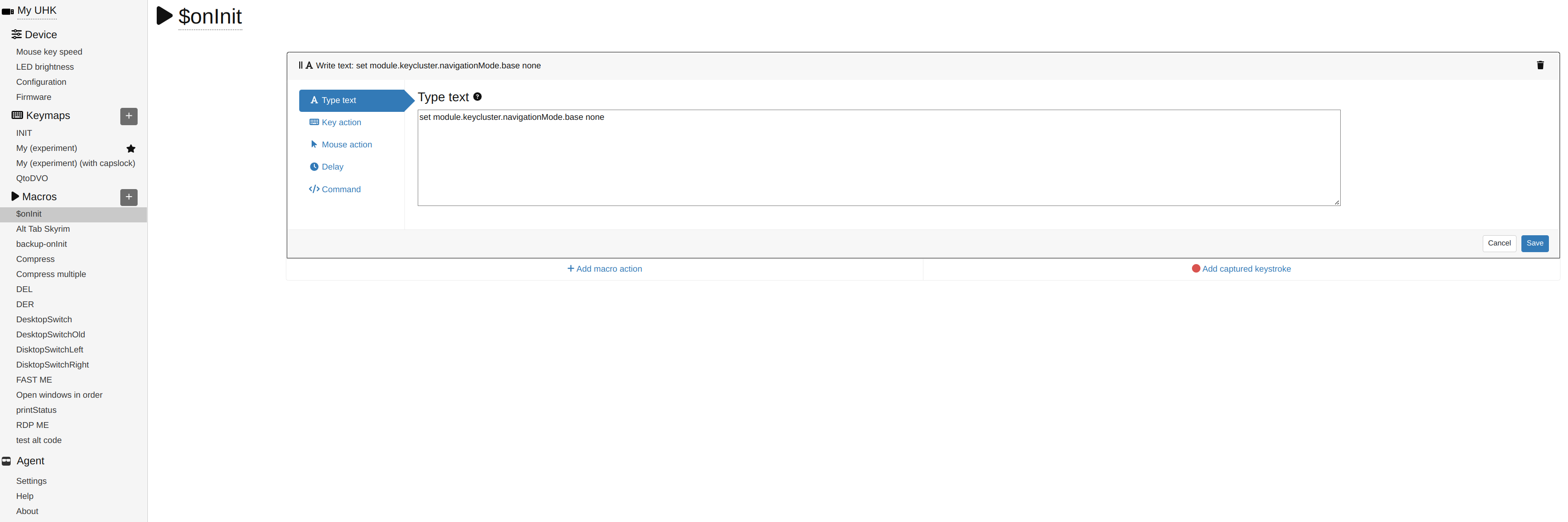

thanks! I have tried setting
set module.keycluster.navigationMode.base none
but my keycluster trackball still works. what am I doing wrong? tried both on $onInit and by running a macros by key press

It should be command action, not write text action (or it has to be prefixed by a dollar in case you are using old fork firmware).
Ah thanks! makes sense. I haven’t noticed the command item because even when “type text” is selected the smart macros help tutorial on the right is showing up so I thought it’s showing up because you’re supposed to write the macros there. Apparently it just shows up always doesn’t matter what you choose.
Yes, now it’s disabled :slight_smile:
