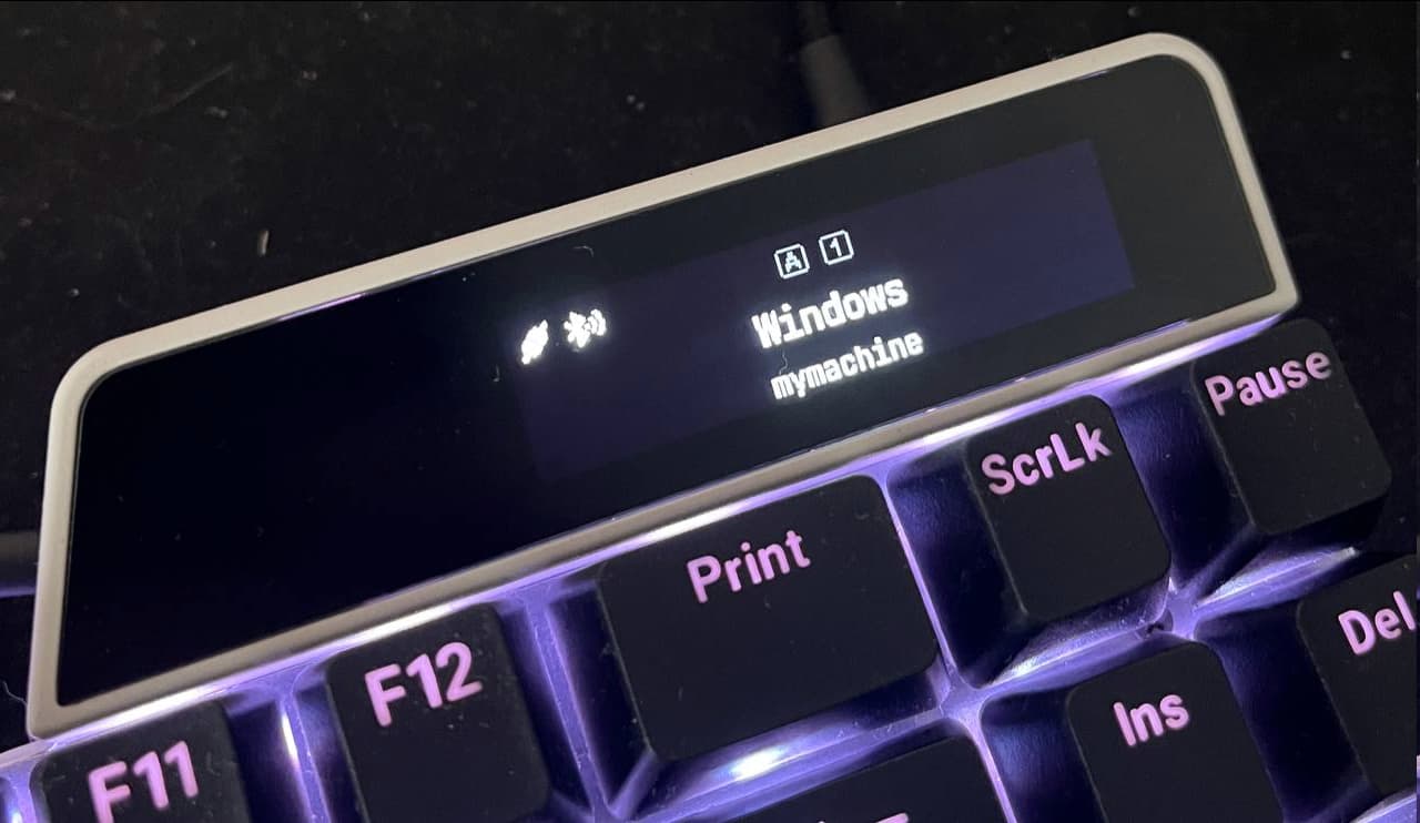

I have my UHK80 connected to PC via USB, halves are also connected via wire, and I don’t have batteries at all.
However, Bluetooth icon appears in the top left corner of the display. And indeed, on my laptop I can find UHK80 among available Bluetooth devices, and initiate pairing. I believe that that started after I upgraded to firmware version 13.0.0.

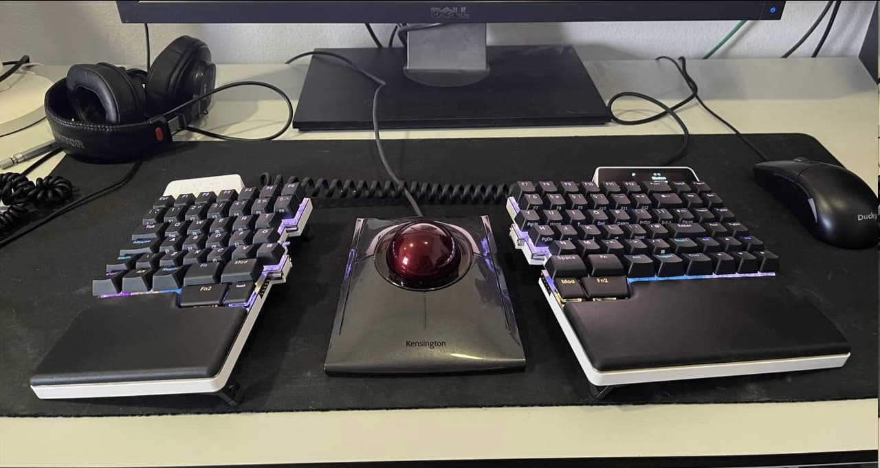

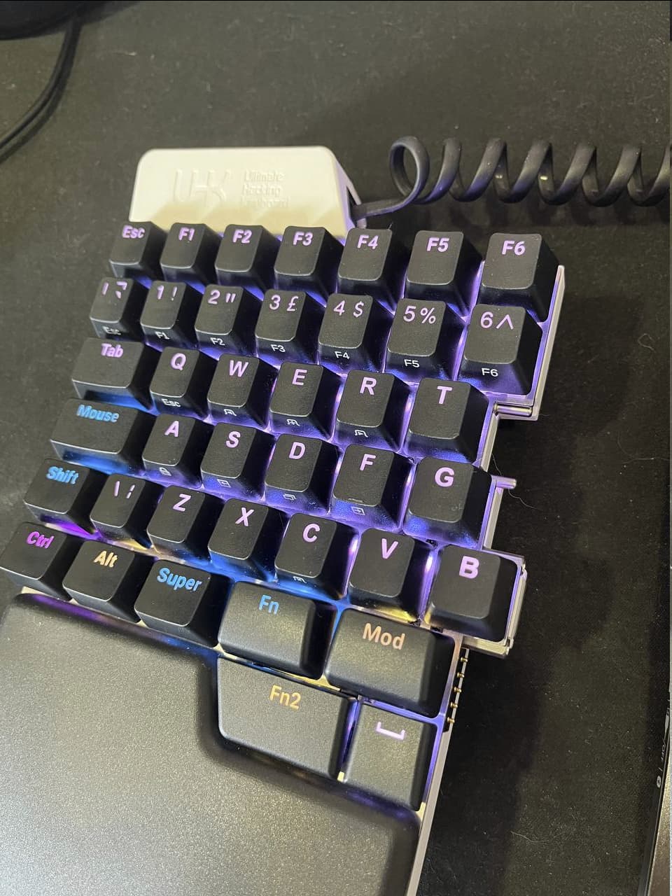

Here are some pics:
I had UHK 60 v1 before, which was black and had a wooden palm rest, and decided to experiment with something new for UHK 80. White case looks very beautiful indeed! I wonder if I can somehow recolor the palm rests to something whiter, though.
Also believe it will look even nicer with blue-white keycaps, which I already ordered form Yuzu. Certainly will show off once again when they arrive :smiling_face:
Please do so!
I really like the white line around the dark OLED display. Wondering if more of those lines could be created, e.g. on top of the left half in place of the large white area.
It does look good, doesn’t it?
When I get my yellow case, i think I’ll try to temporarily fill the recessed logo on the left half with wax or something and use black paint around it to mimic the right side.
I’m at least gonna paint the logo itself black or something to give it some contrast.
Looking forward to seeing that!
Hi @pcooke9 is this supposed to make the Bluetooth icon disappear from the OLED display:
set bluetooth.enabled false
I have this configured as a macro, but if I hit the key that is bound to the macro the icon still appears on the display.
Am I doing something wrong?

I assume the icon should go away, but you’re right, it doesn’t. It seems to only be a graphical bug though. The set bluetooth.enabled false macro is a global BLE kill-switch AFAIK (including the dongle). I tested it to be sure, and my dongle/BLE devices are still being disabled (as they should), regardless of the icon status.
Just for clarity; the BLE icon currently retains it’s OLED visibility status when using set bluetooth.enabled 0. If you change the BLE advertising mode while it’s disabled, the icon will update after re-enabling BLE via set bluetooth.enabled 1.
The same is true with the BLE pairing mode icon.
Until a fix is available, you can disable the BLE icon with bluetooth noAdvertise, and then use set bluetooth.enabled 0 to fully disable BLE (if fully disabling it was what you were wanting to do).

Also, so I tried to run the bluetooth noAdvertise command as part of a macro, but it does not seem to have any effect on the icon, maybe I’m doing something wrong, I’m not a macro expert yet.
I also tried to enable bluetooth first with a macro (set bluetooth.enabled 1), and run the bluetooth noAdvertise after that, but the icon stays.
I’m on 13.0.1.
