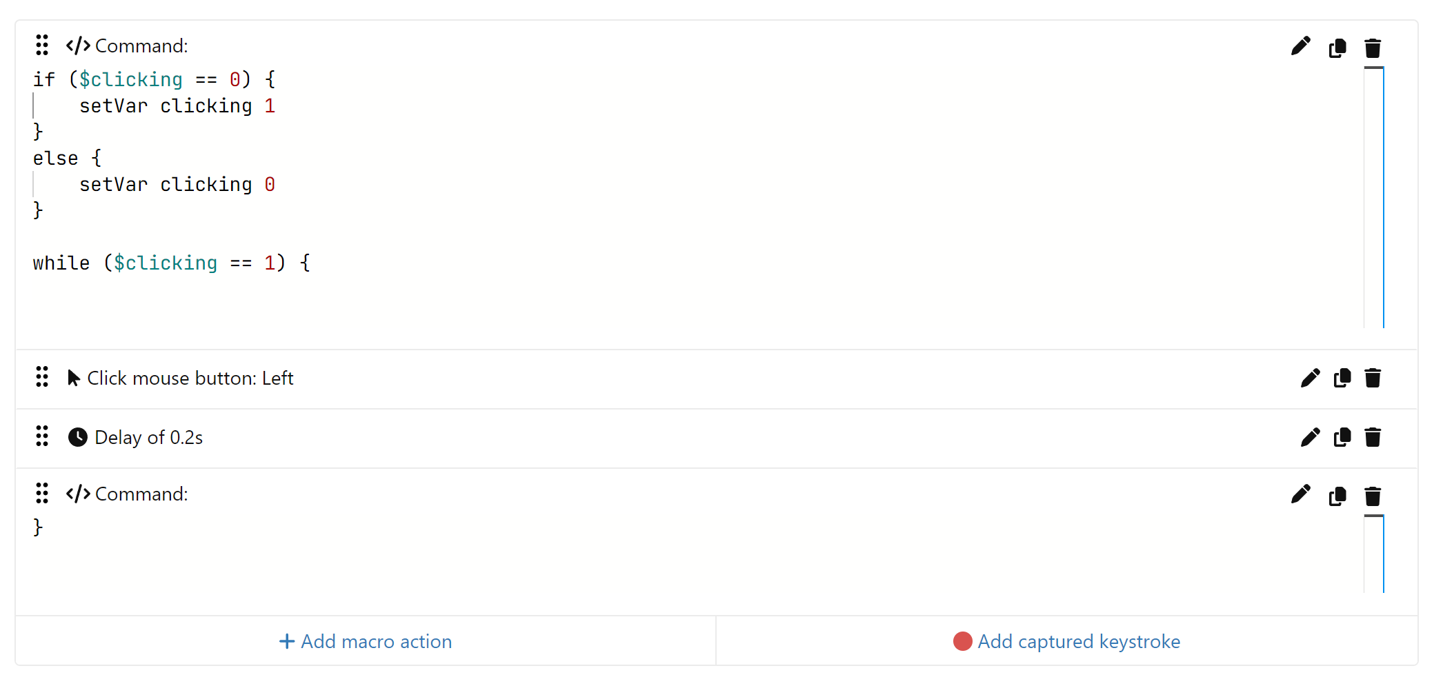

I created below macro. Is it correct? I set clicking to 0 in $OnInit.

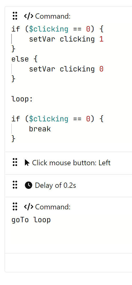

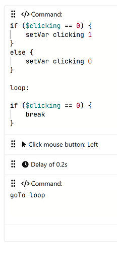

I managed to make it work. It seems that a single statement like while can’t cross two command blocks. I use below code to eliminate the use of while and still do the trick.
