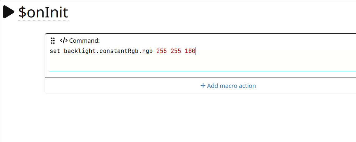

The default “white” backlight color of the UHK is a bit blueish or cold white, which we are considering correcting on the firmware level. The preferred color is neutral white.
Use the following command in the $onInit macro to experiment and adjust 180:
set backlight.constantRgb.rgb 255 255 180
Considerations:
  • Use the original black PBT keycaps supplied with your UHK. Other keycaps affect the backlight differently.
  • Connect your UHK via USB. The lower the battery runs, the more brownish the backlight becomes, and we don’t want the color to be affected by a low battery.
Thanks for your help!
Is this the way to do it?
If so, what is this “180:” doing?
No, without the leading 180: :wink:
