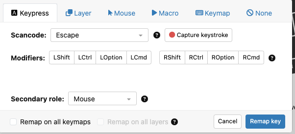

Hi,
one of the more recent updates has added the option of setting a secondary role for a key.
Following the recommendation of the hints in agent I have set the scan code for the caps lock key to “Escape” and the secondary role to “Mouse”.
It works like expected. I can send escape by tapping caps lock and if I hold it down and e.g. press one of the arrow keys the pointer is moving.
What also works as expected, is the secondary role being triggered, as described in the hint, when caps lock is held down and another key is pressed.
Before a second key is pressed the keyboard doesn’t go into its secondary role mode and thus the functional backlighting is not activated.
The keyboard stays lit completely, unlike when I hold down Fn or Mod.
Before using caps lock with the secondary role it would enable the functional backlighting for the mouse layer on hold too, but I really miss escape on caps lock, so I’d rather guess keys when it is dark :smiley:
Is there a way to make it light up the mouse layer keys when the caps lock key is held down, even before I press another key?
Be it by enabling the secondary role mode on caps lock down or with some sort of workaround that triggers the functional backlight for this layer.
Thank you

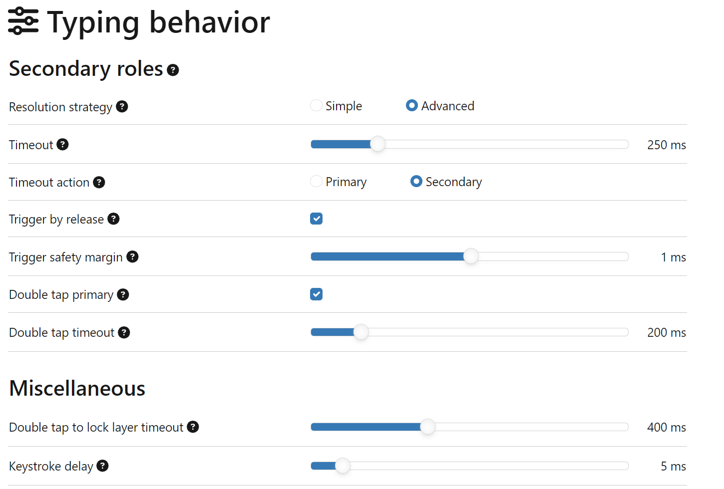

You might not need the macro.
With the advancedStrategy for secondary roles you can define a timeout. It will then only switch the the secondary role if you either press a second key while the dual-role key is held down, or the timeout expires. I use this for my maxtend and numtab keys, so they don’t switch layer when I only briefly tap them.
These are the settings I use for Typing behaviour:
In macros, I differentiate primary/secondary roles with ifSecondary advancedStrategy, but it’s probably sufficent to just configure the secondary layer switch directly in Agent:
Awesome! Thank you for sharing your config. I will try that!
Edit: worked like a charm! Thanks!
