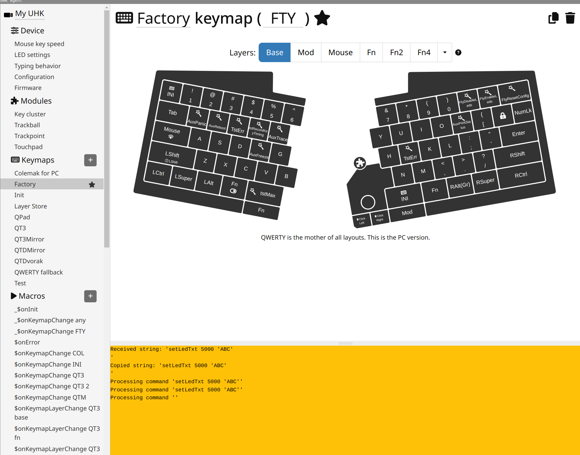

Let’s dive deeper. Please flash this firmware:
Then:
  • Remove any macro events from your UserConfig (either backup your config, or just prefix them with ‘_’…)
  • Save the config.
  • Kill Agent.
  • Run your uhkcmd command. (Exactly one command. Not a sequence of uhkcmd calls.)
  • Open Agent again.
  • Copy and paste the log.
I am seeing this:
