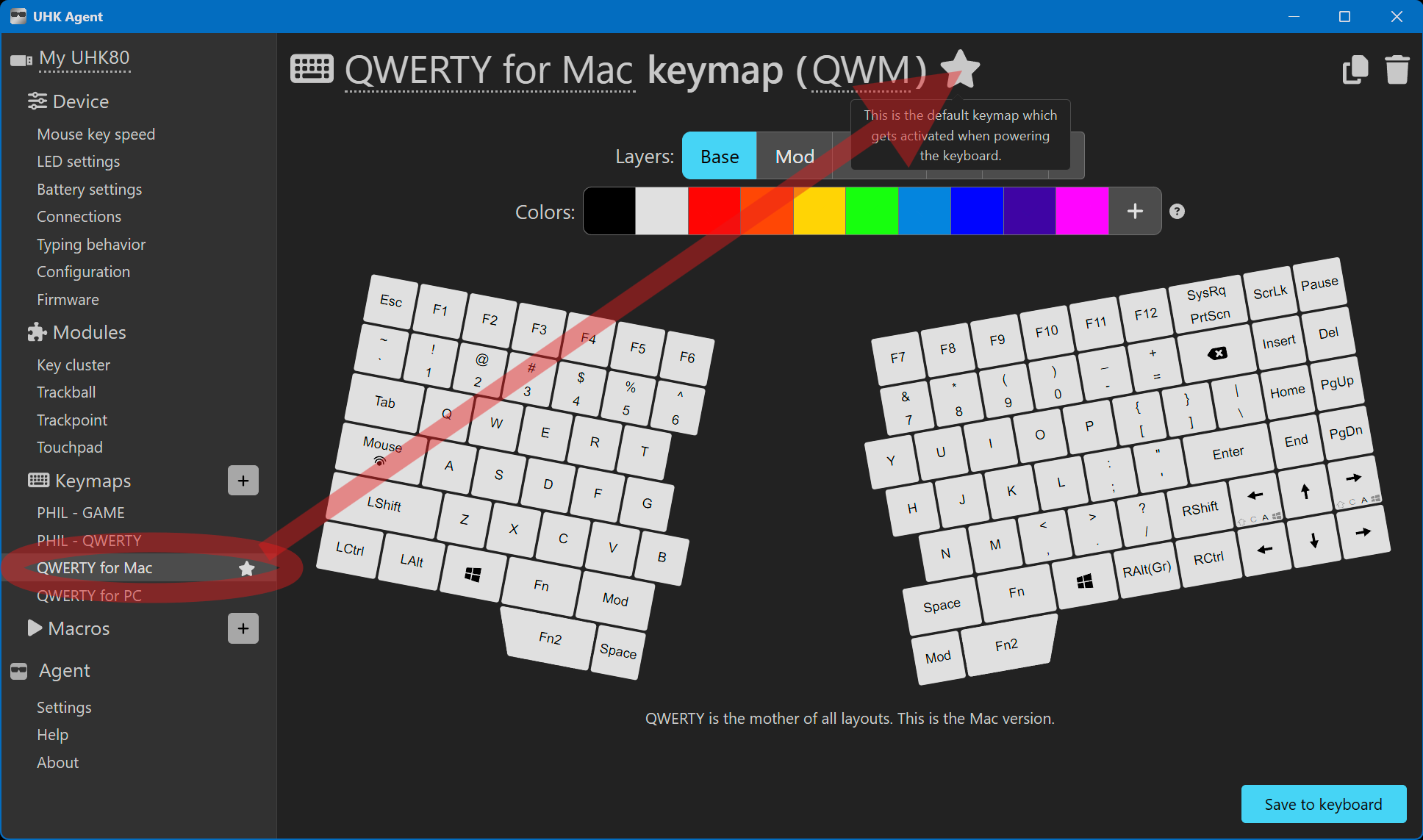

I feel dumb, but: how do I change the star? I tried clicking and so on and I can’t change it.
First, select the Keymap in the left panel, and then click the big star in the main central pane.
